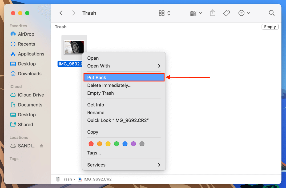

To Recover Deleted Files From SD Card’s Trash Folder:

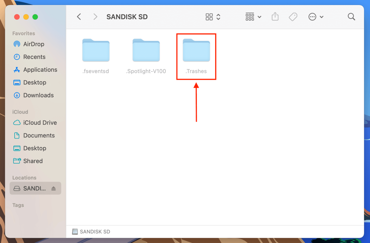

- Open Finder and navigate to your SD card’s root folder.
- Hit the key combination (CMD + Shift + >) to show hidden files, revealing the .Trashes folder.
- Open the Trash folder within the .Trashes folder and locate your deleted files. Right-click the item you want to recover, and click “Put Back.”

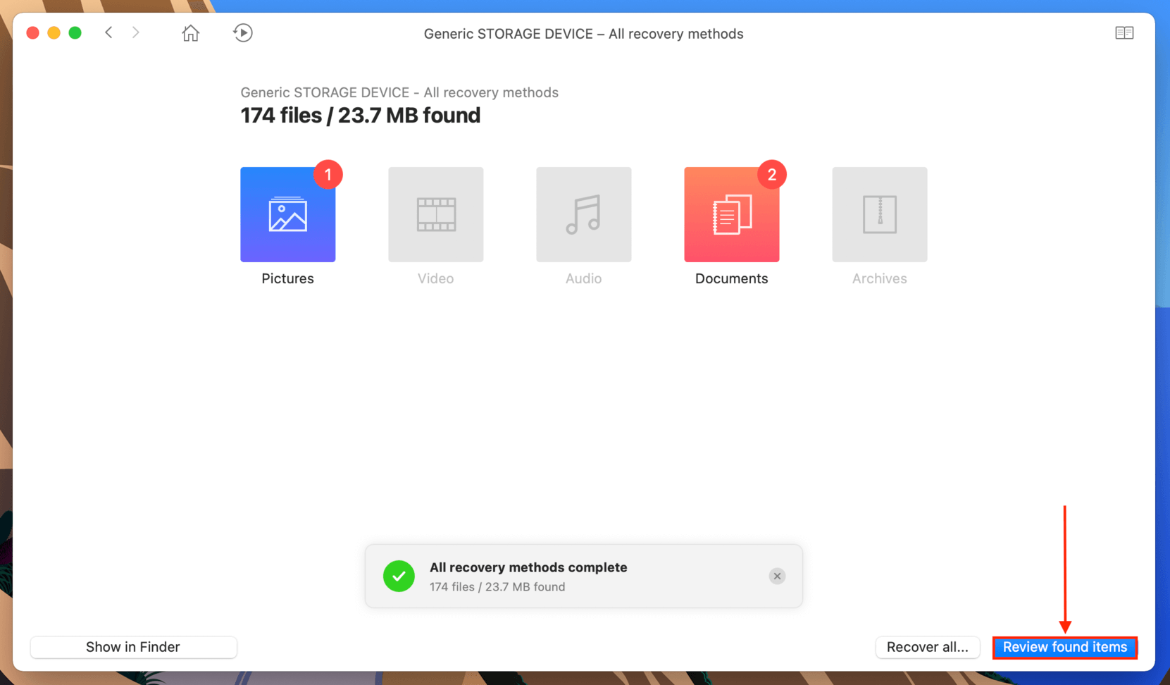

- Select your SD card from the list of drives (if you’re using a USB-type card reader, it may appear as “Generic Storage Device.” Leave scan settings to “All recovery methods” and then, click “Search for lost data.”
- Wait for Disk Drill to complete its scan, then click “Review found items.”

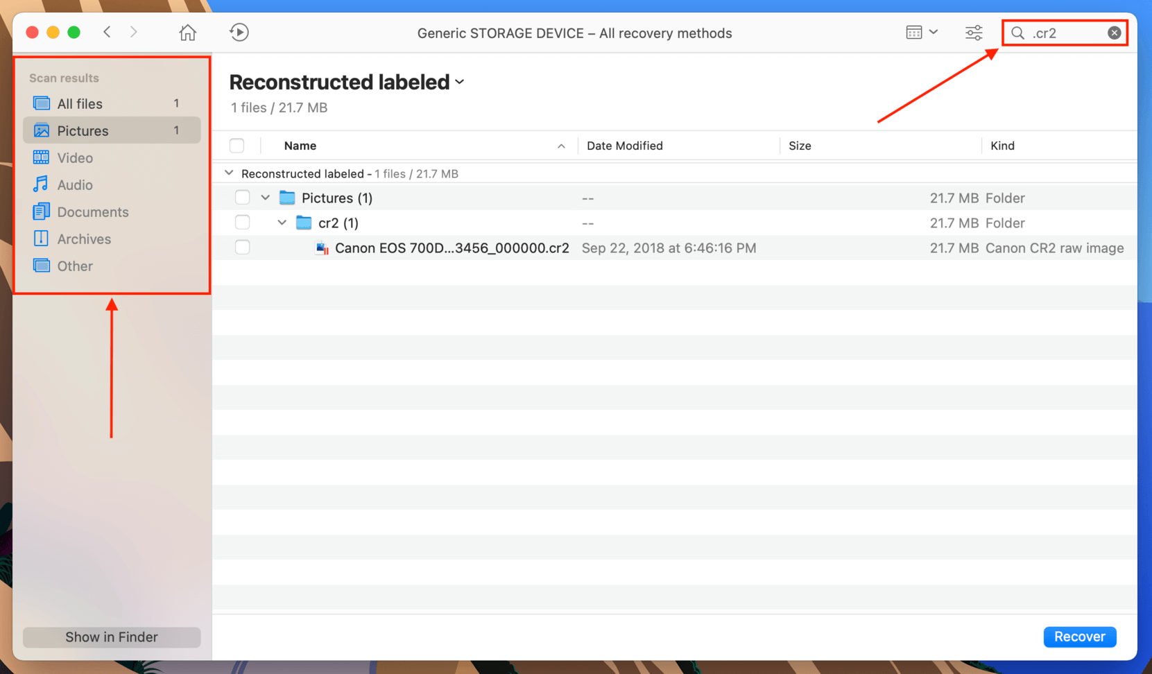

- Browse the list of items Disk Drill found for the files you want to recover. You can use the search bar in the top-right corner of the window to specify file names or file types (for example, .cr2 for RAW photos) or use the left sidebar to filter results by file type.
- Hover your mouse to the right of each file name and click the eye button that appears. This will open a new window displaying a preview of that file so you can make sure it’s intact.

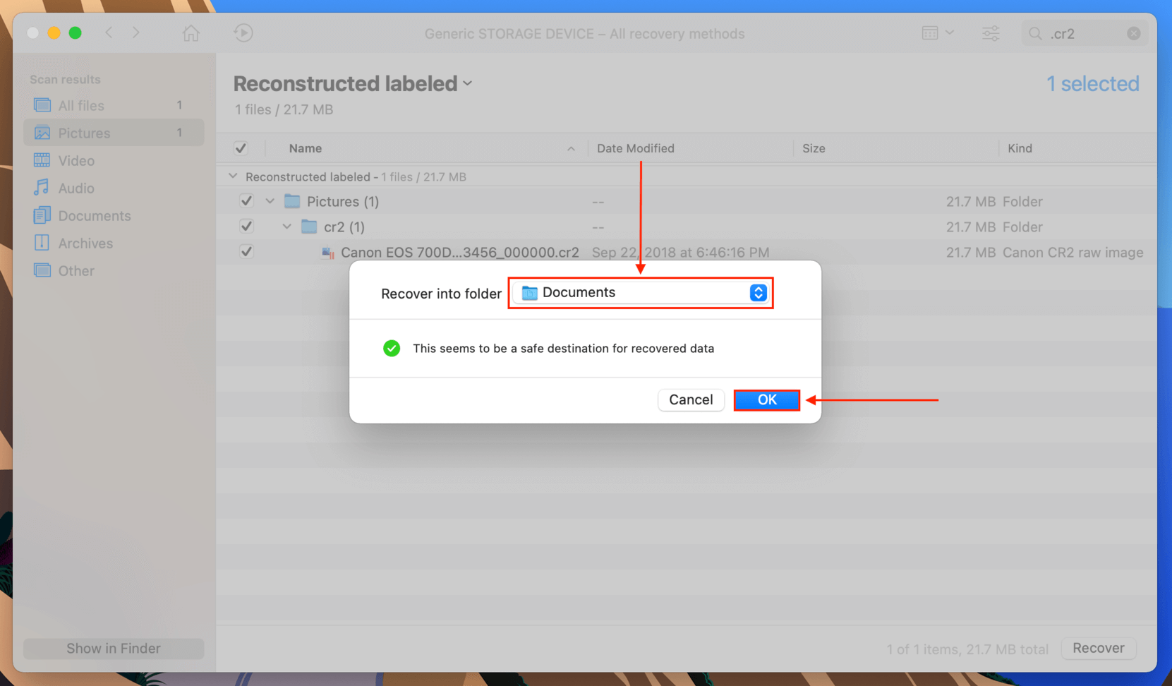

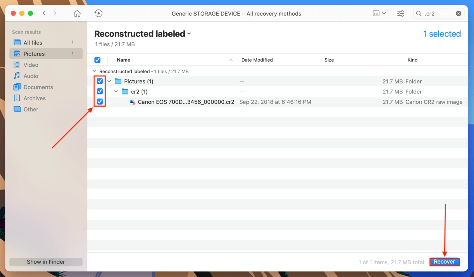

- Select the files you want to recover using the checkboxes in the left-most column of the Disk Drill window. Then, click “Recover.”
- In the new window that pops up, use the dropdown menu to choose a destination for your recovered files. Make sure to select a location on your computer to avoid overwriting data on your SD card. Then, click “OK.”

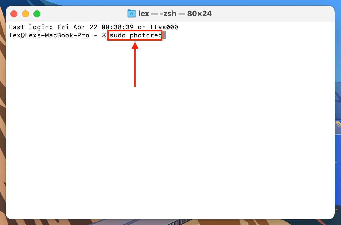

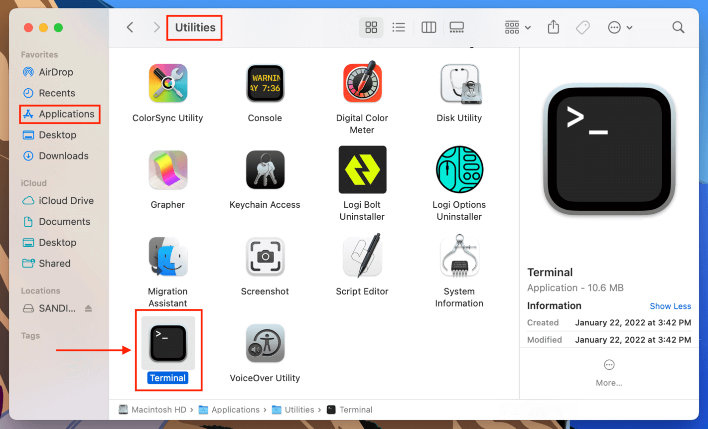

- Launch Terminal (Finder > Applications > Utilities > Terminal).
- Type the following command and hit return (enter your password if prompted):

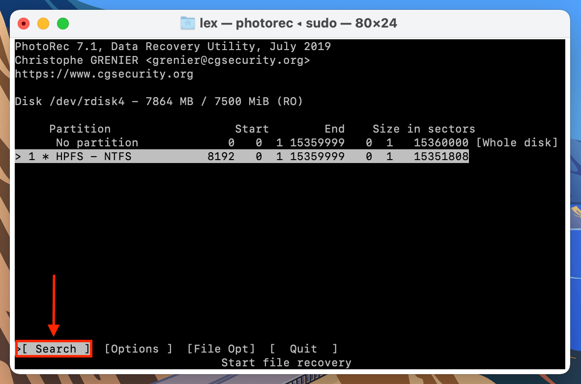

sudo photorec

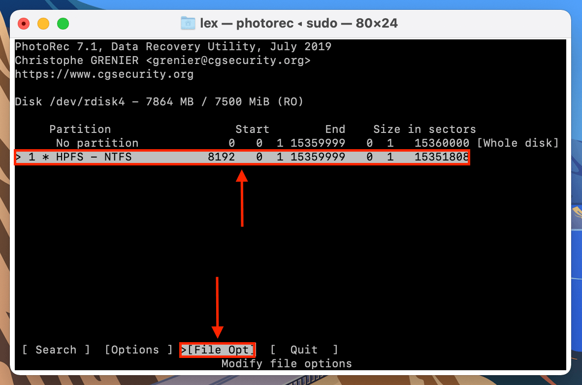

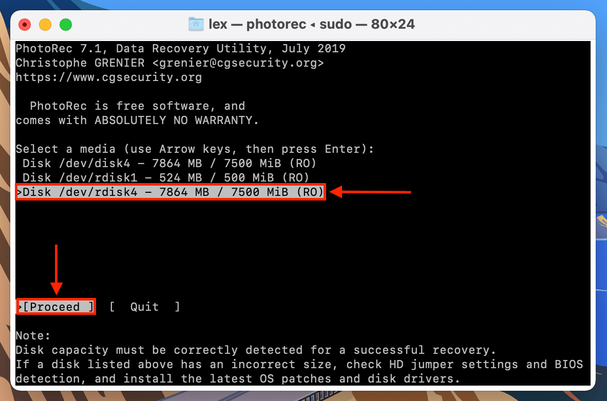

- Use your arrow keys to move up and down the list and select your SD card (you can figure this out by comparing disk sizes in Disk Utility). It’s also a good idea to choose the “rdisk” volume instead of “disk” for a more comprehensive scan. Then, hit return.
- Choose the partition that contains your data, then use your arrow keys to highlight “File Opt” and hit return.

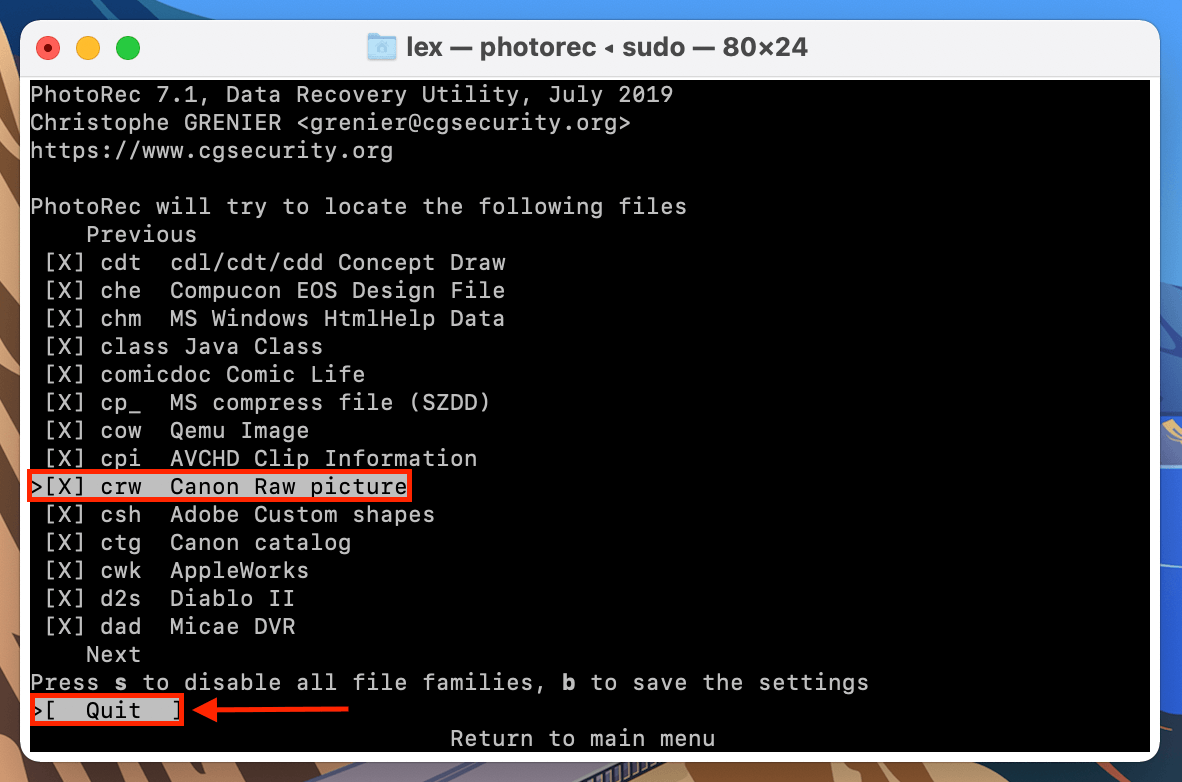

- Browse the list to make sure the file types you want to recover are ticked (ex. RAW files), then hit return to go back to the last screen.
- Use your arrow keys to highlight “Search”, then hit return.

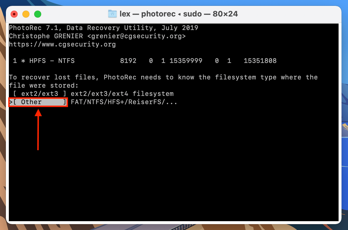

- Select “Other”, then hit return.

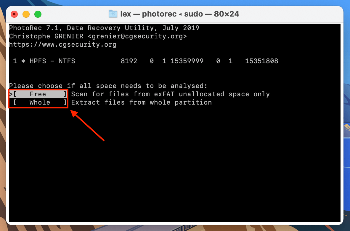

- If you accidentally deleted your files (or formatted your SD card), choose “Free.” If your data (or entire SD card) is corrupted, choose “Whole.” Hit return.

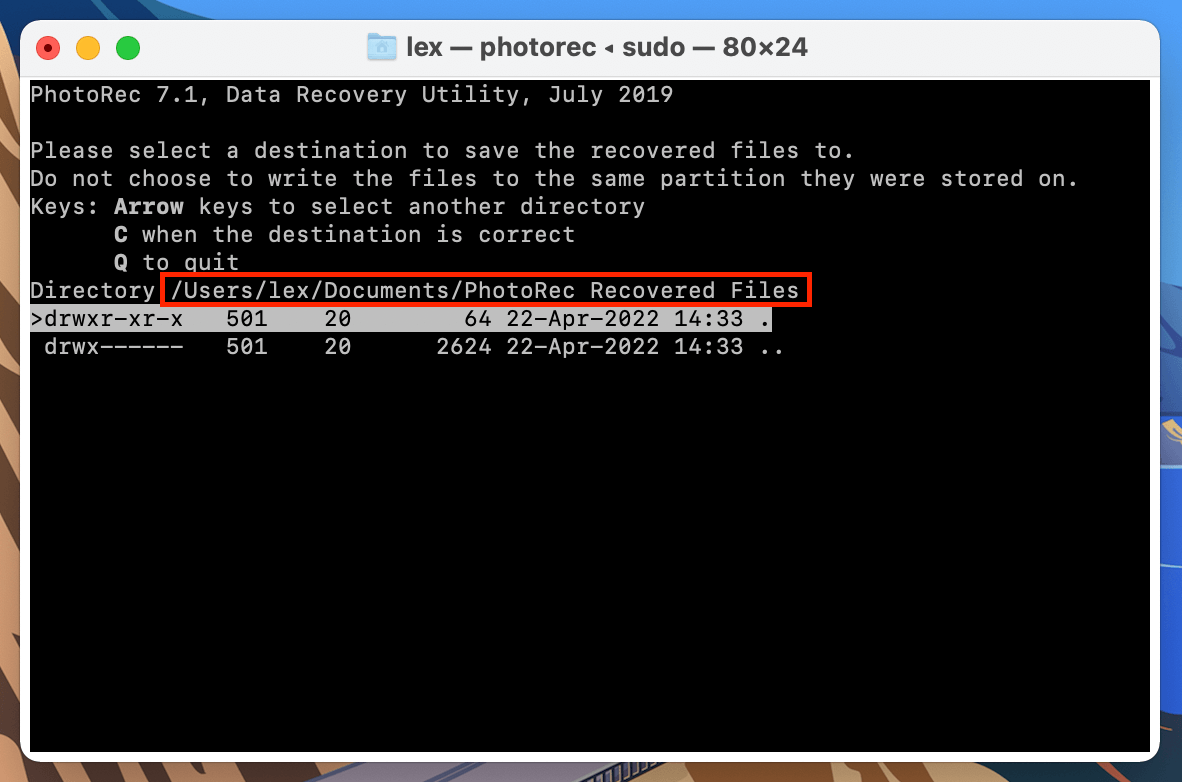

- Choose a destination for the recovered files, then hit (C) to confirm and begin the recovery process. Here’s a tip: Use the left and right arrow keys to go deeper into folders.
Once PhotoRec completes the recovery process, your files will be saved in a folder named “recup_dir” or “recup_dir.1~” in your selected destination.
