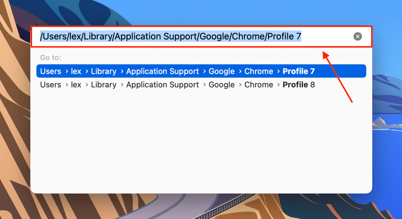

To find the Chrome bookmarks location on Mac, launch Chrome and type “chrome://version/” in the address bar without the quotations. Hit return. You’ll find the exact path to the location of your bookmark files next to “Profile Path”, which you can paste into Finder’s Go to folder function.
Keep in mind that chrome://version/ displays information about the account you have currently logged into Chrome. If you can’t find the bookmarks you’re looking for, check if you’re logged into the right account.

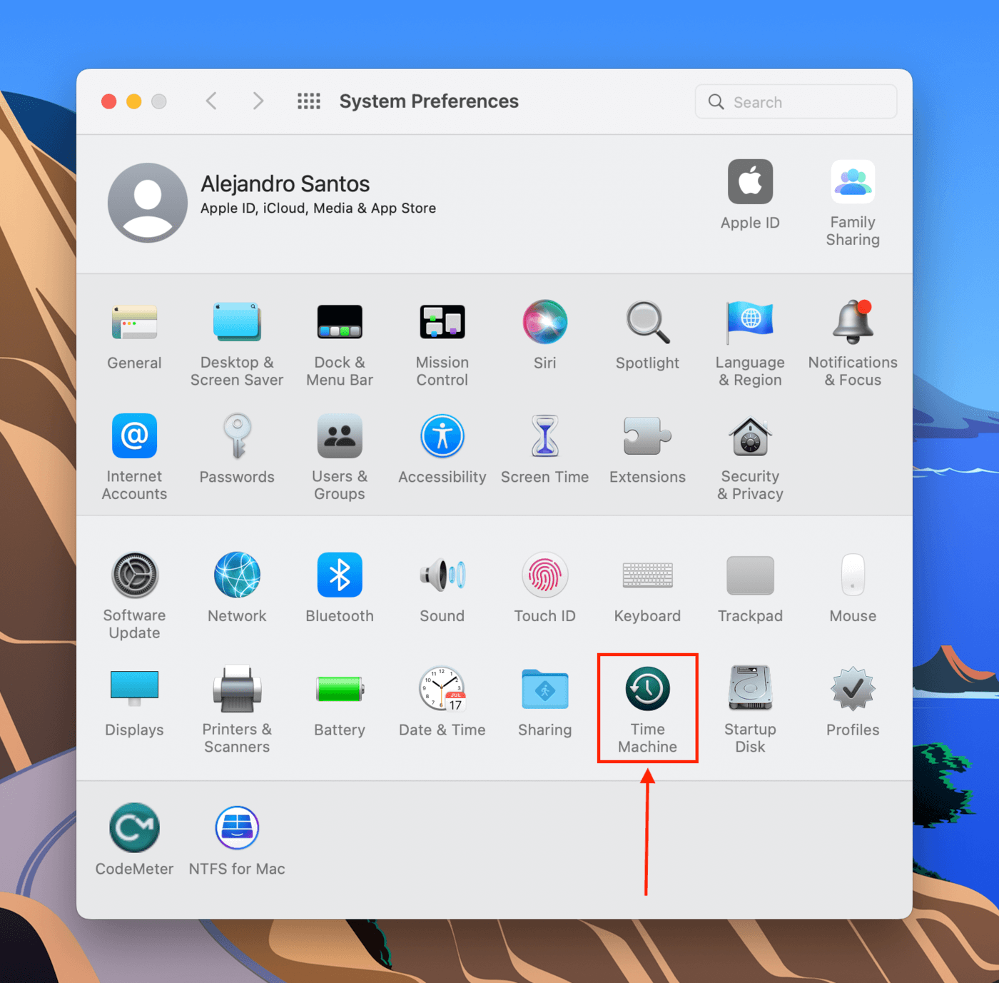

Step 1. Open System Preferences > Time Machine.

Step 4. Open Finder, then on the menu bar click Go > Go to Folder… and paste the path we just copied into the field. Hit return.

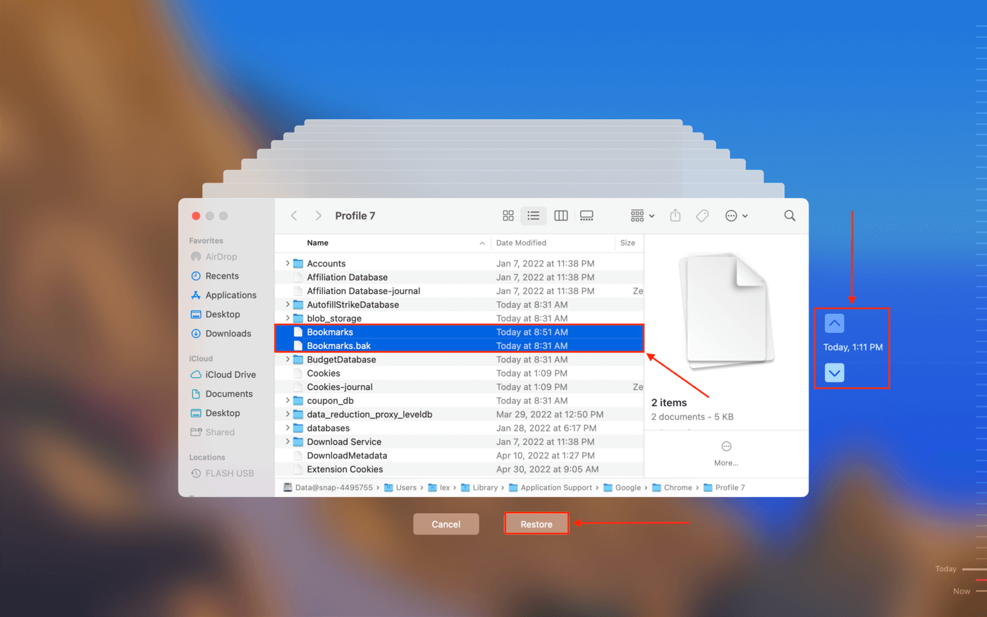

Step 5. On the menu bar, click the Time Machine button > Enter Time Machine.
Enter Time Machine button
Step 6. Use the arrows on the right of the screen to browse snapshots until you find one where your bookmark files have not yet been deleted. Highlight these files, then click “Restore” to restore your deleted bookmark files for Chrome.

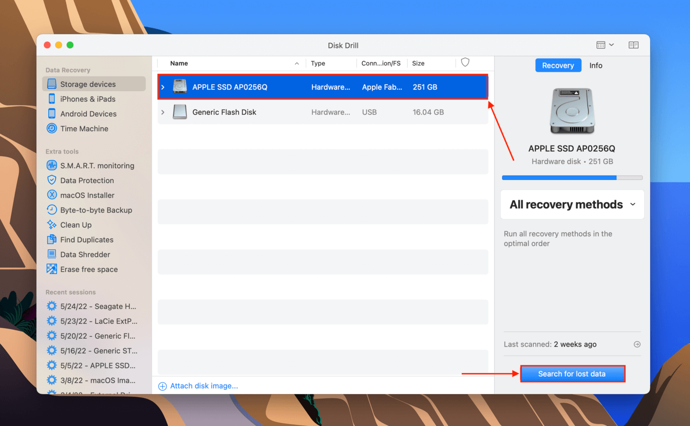

Step 3. Open Finder > Applications and double-click the Disk Drill icon.

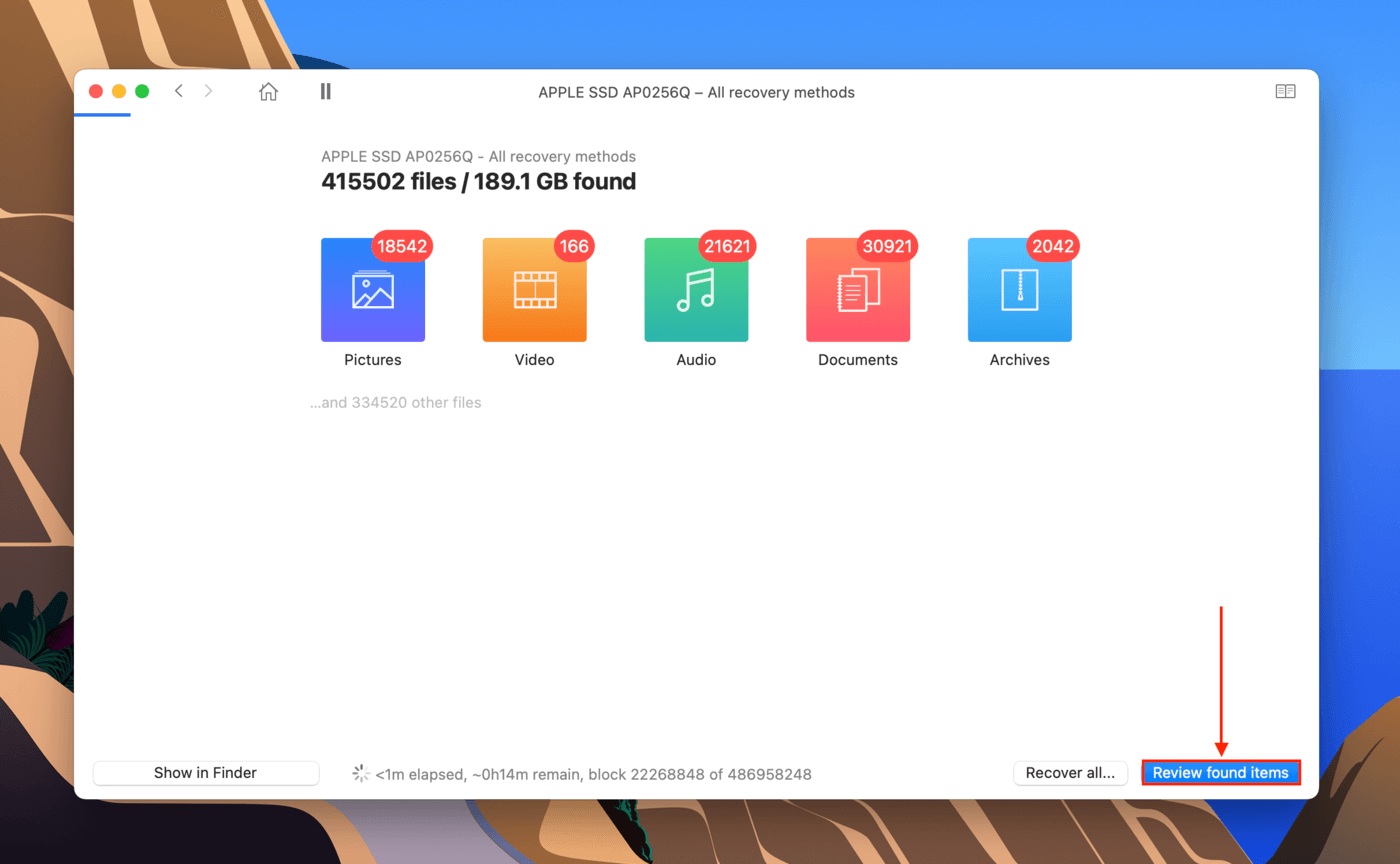

Step 4. Select your system drive from the middle pane and click “Search for lost data.”
Step 5. Wait for Disk Drill to complete its scan, then click “Review found items.”

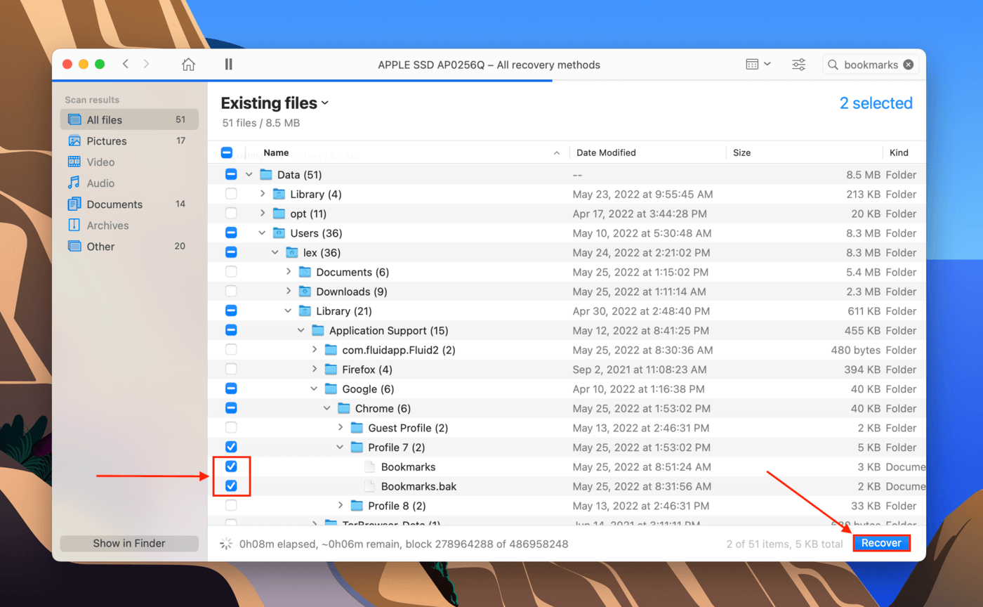

Step 6. On the top-right corner of the window, click on the search bar and type “bookmarks” to filter the list for the files related to your accidentally deleted bookmarks.
Disk Drill search bar
Step 7. Depending on how fragmented the data is, you might be able to follow the original path directly to the missing bookmarks files. Use the checkboxes in the left-most column to select the files you want to restore, then click “Recover.”
Disk Drill file selection column

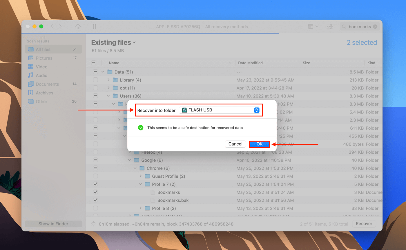

Step 8. Select your storage device as the destination where Disk Drill will save the recovered files (not your computer system drive, to avoid overwriting). Click “OK.” You can then safely move the recovered Bookmarks and Bookmarks.bak files into the “Profile Path” folder for it to appear on Chrome again.
