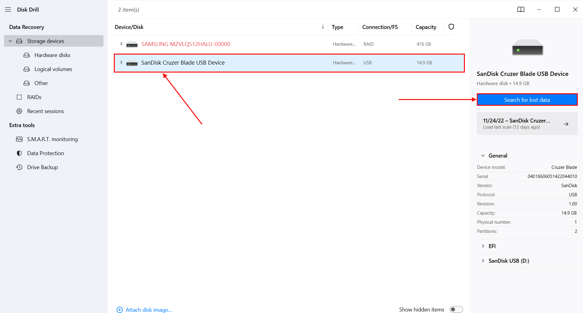

  3. Select your drive from the middle pane (if using an enclosure, it may have a generic USB name) and click Search for lost data.drive selection window in Disk Drill

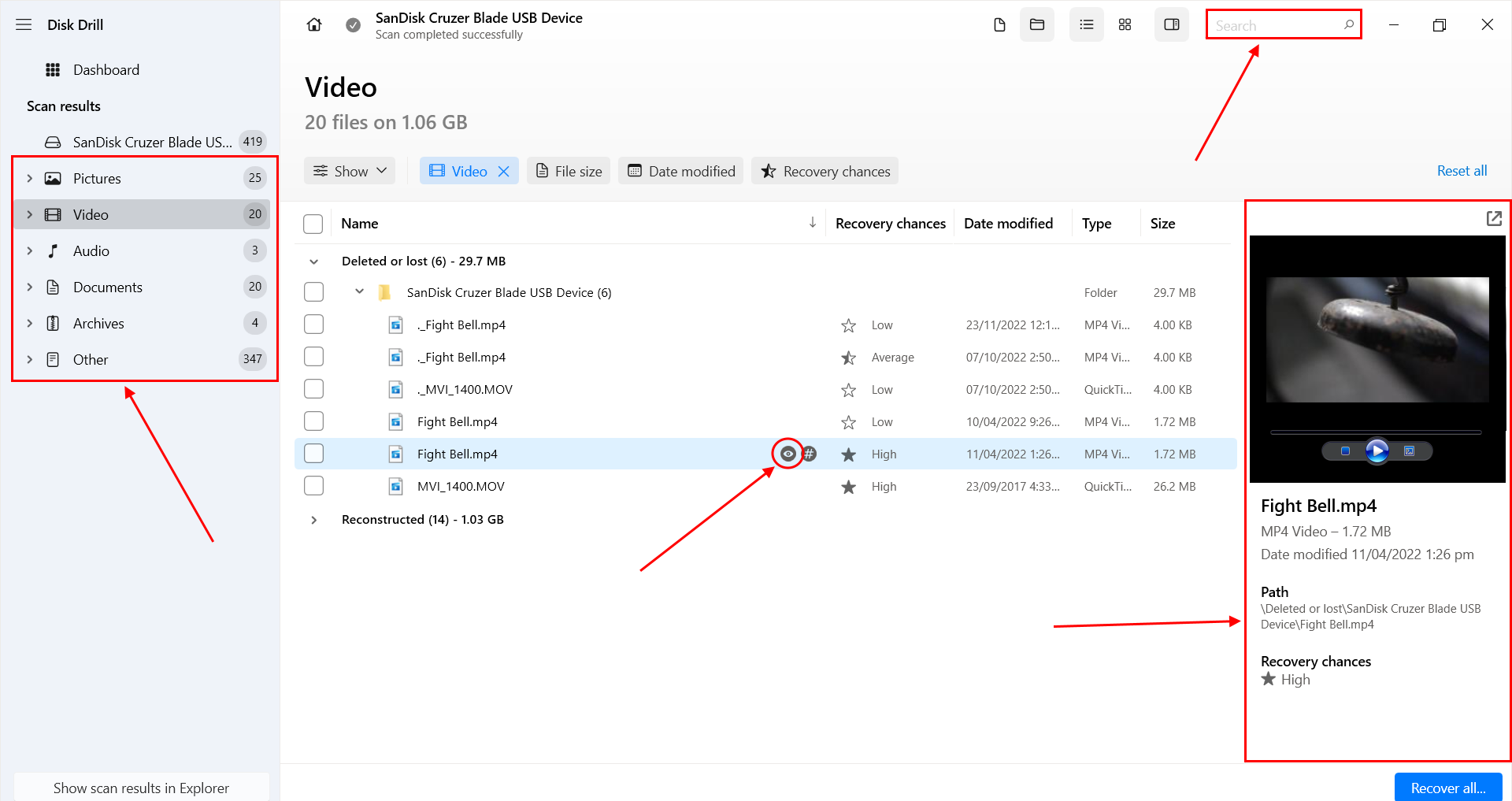

  4. Once Disk Drill completes the scan, click Review found items.scan results in disk drill
  5. If you only want to restore specific files, you can use the left sidebar to filter the data or use the search bar (click the magnifying glass) in the top-right corner. Preview your files by hovering your mouse pointer beside them and clicking the eye button that appears.preview window in disk drill
  6. Select your files by clicking the boxes in the leftmost column or by clicking the select all box in the column header. Then, click Recover.file selection window in Disk Drill

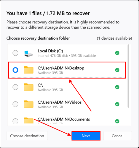

  7. Choose a location on your PC where Disk Drill will save the recovered files. Then, click Next to proceed with recovery.destination folder selection dialog in disk drill

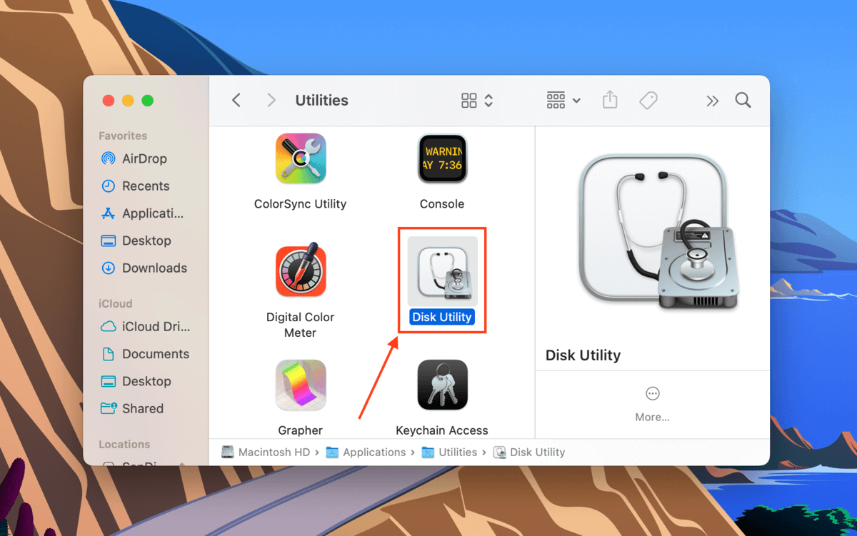

This is especially useful for non-booting Macs as Disk Utility can be launched from Recovery Mode.

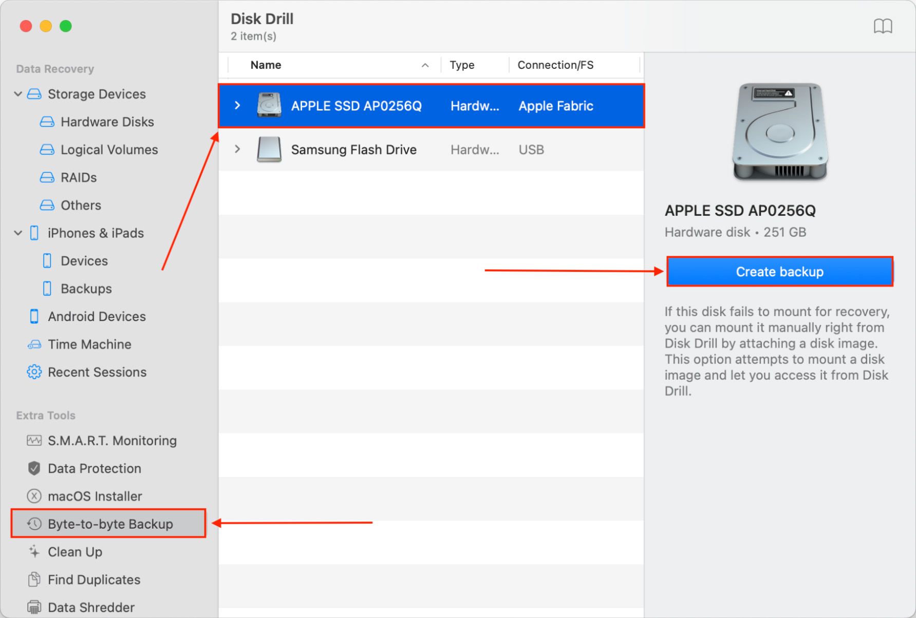

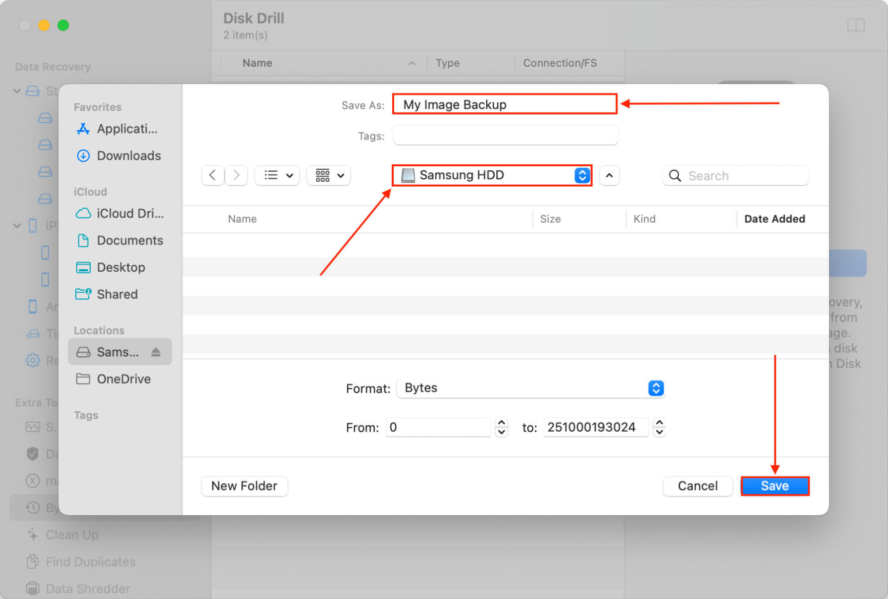

If you use Disk Drill, you can skip Disk Utility and create an image using Disk Drill’s Byte-to-byte backup tool and scan that instead. Like Disk Utility, you can launch Disk Drill on a non-booting Mac via Terminal in Recovery Mode.
On your Mac:
  1. Connect a USB or external drive to your Mac, ensuring that it has enough space for the image file.

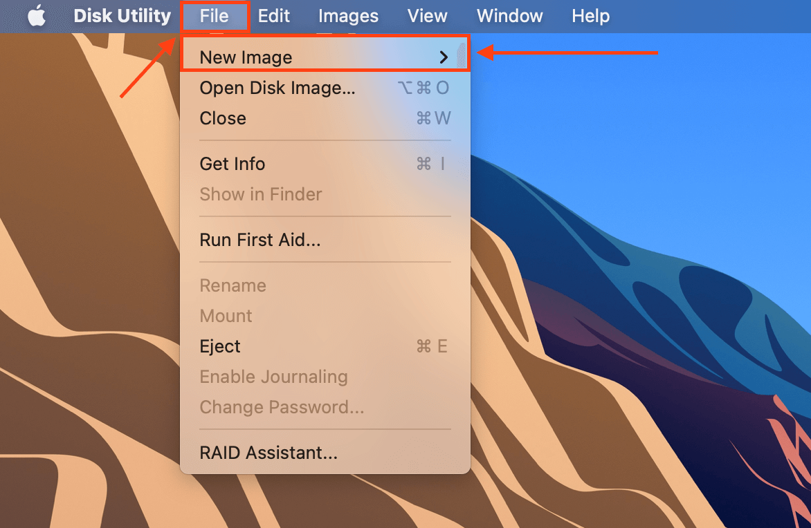

  2. Launch Disk Utility (Finder > Applications > Utilities).disk utility icon in Finder
  3. Select your drive from the left sidebar. On the menu bar, click File > New Image > Image from “Drive Name”.File menu

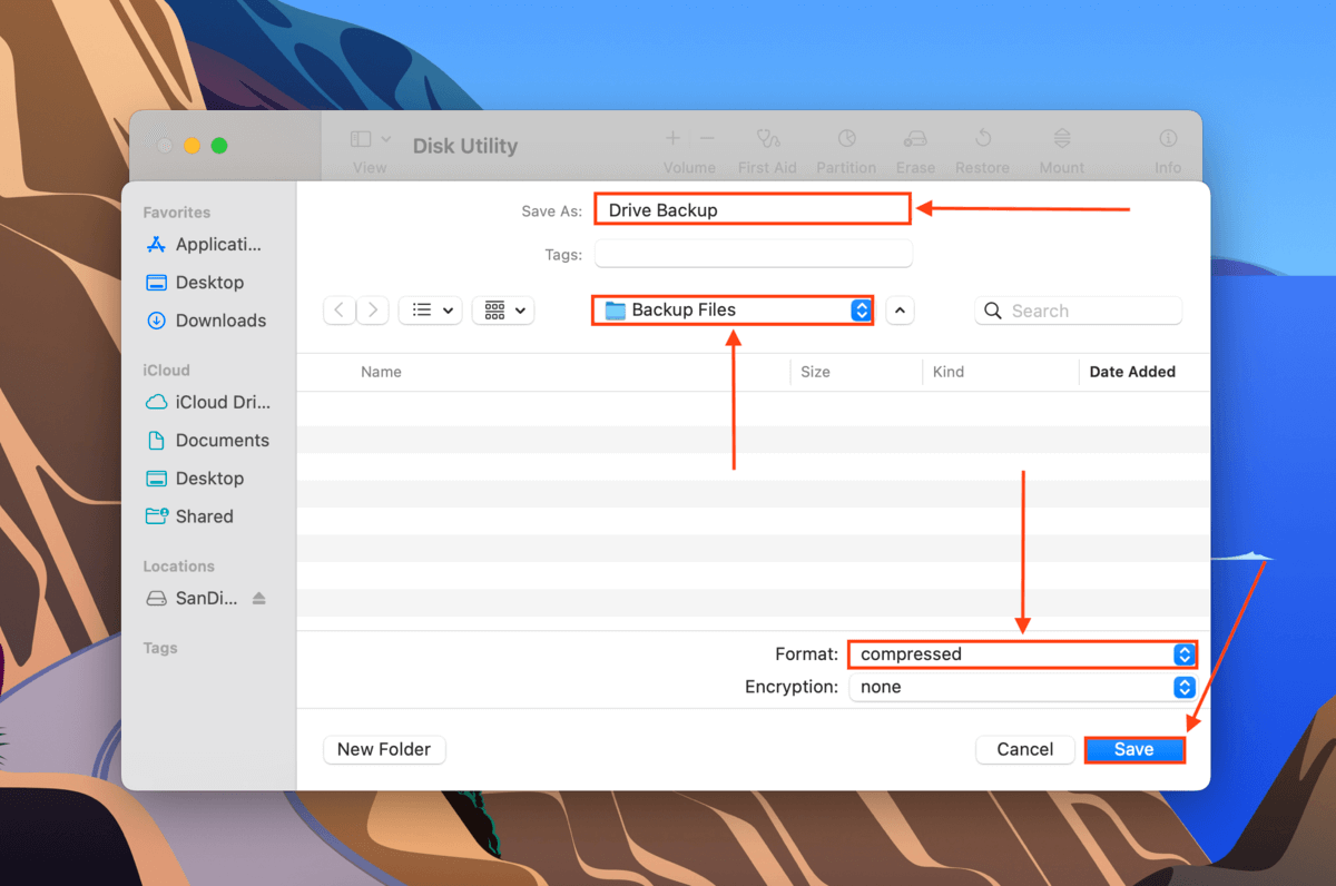

  4. In the dialogue box, name your backup file, select compressed for its format, and opt to save it to the external storage device we connected in Step 1. Disk Utility images use the DMG extension, which is compatible with Disk Drill. If you used another tool to back up your files, your image backup uses one of the following extensions: DMG, RAW, DD, IMG, ISO, DSK, BIN, DAT, VMDK, VHD, or VHDX.drive backup window in Disk Utility
  5. Safely eject the storage device.

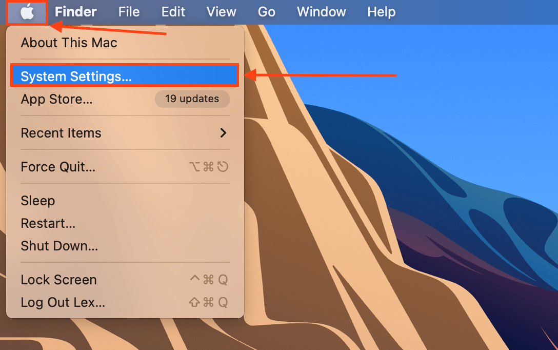

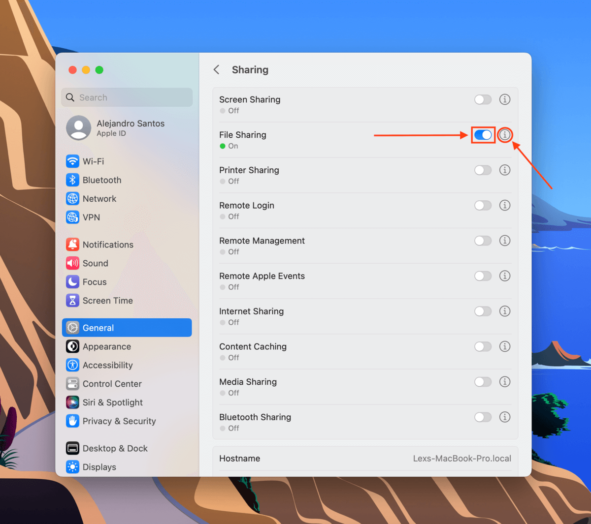

  1. Click the Apple menu button > System Settings.System Settings in Apple menu

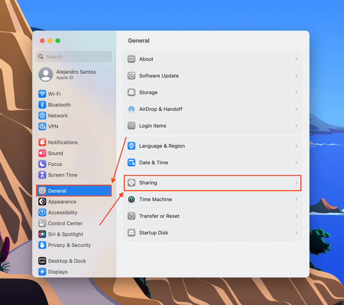

  2. Click General on the left sidebar and select Sharing.General tab in System Settings

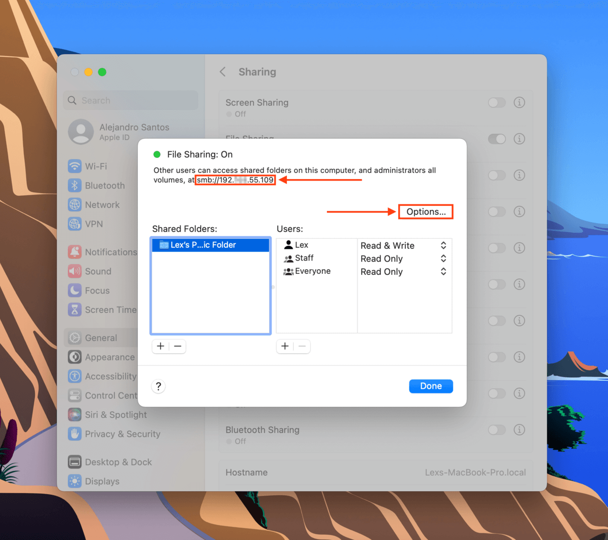

  3. Turn File Sharing on by clicking the toggle to the right, then click the i button beside it.File Sharing button in System Settings
  4. First, take note of network address under File Sharing: On. You’ll need this later when you connect your Windows computer to your Mac’s network. Then, click the Options button and a new dialogue box will appear.File Sharing dialog

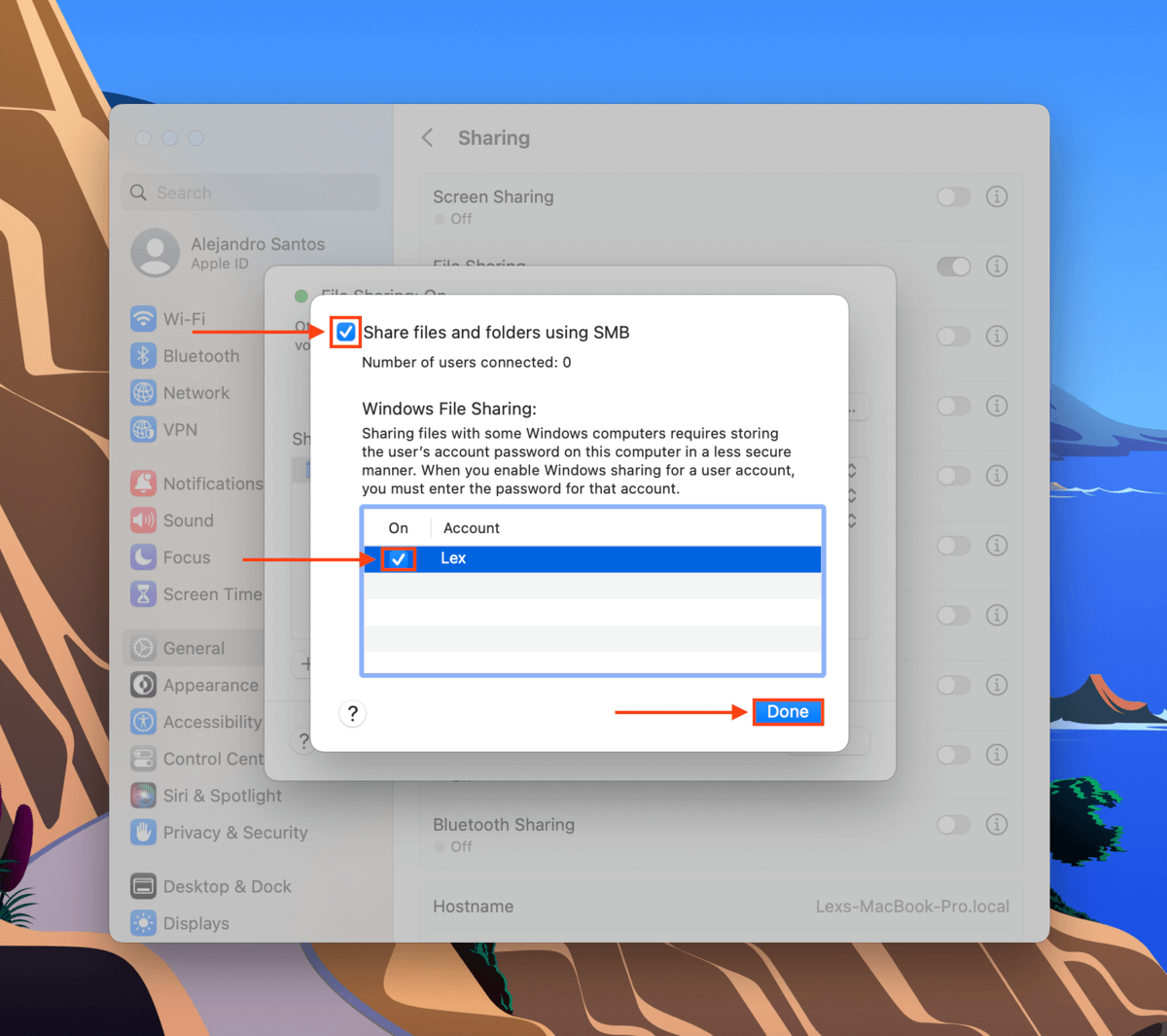

  5. Tick the boxes beside Share files and folders using SMB and beside your Mac user account. Then, click Done.Options menu in File Sharing

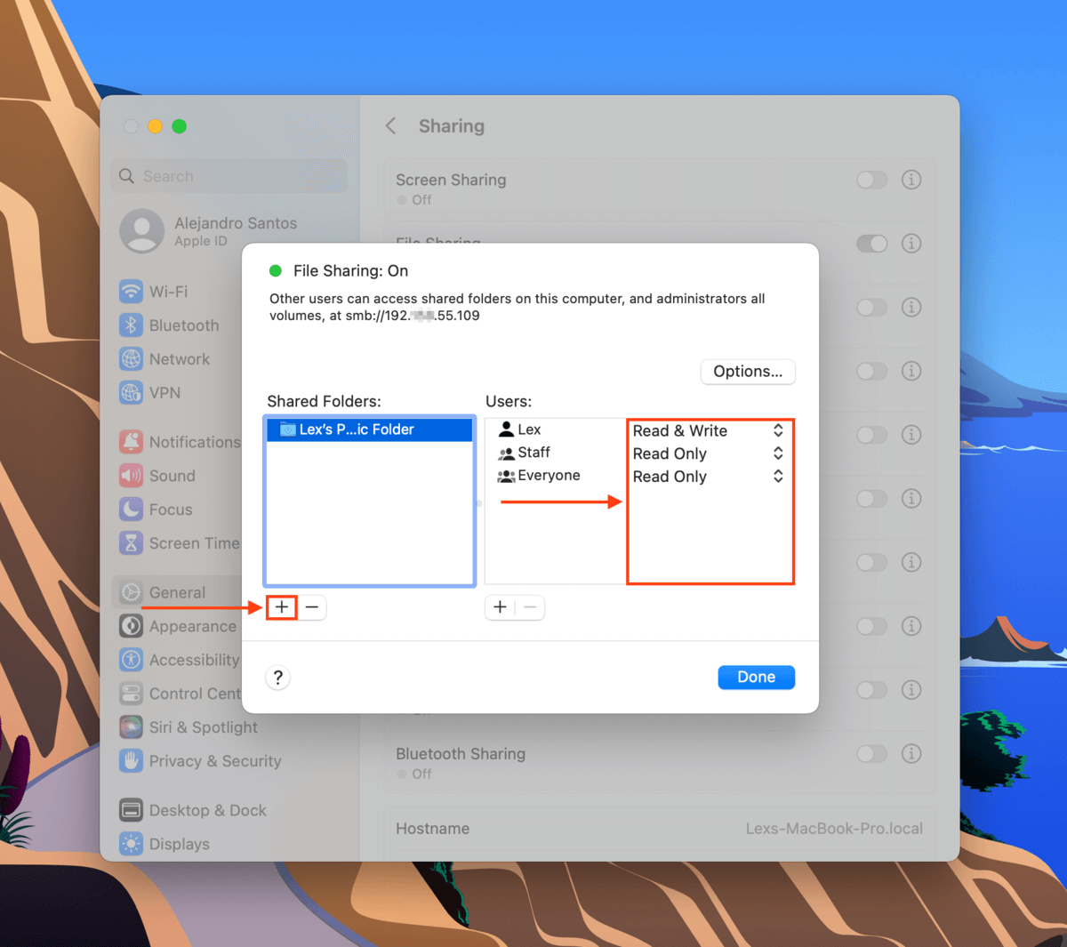

  6. You can use the default Public folder to transfer your files. To add a new folder to the network, click the + button. You can add multiple folders or consolidate your files into one “transfer” folder. You can also edit folder permissions from this window.Permissions in File Sharing

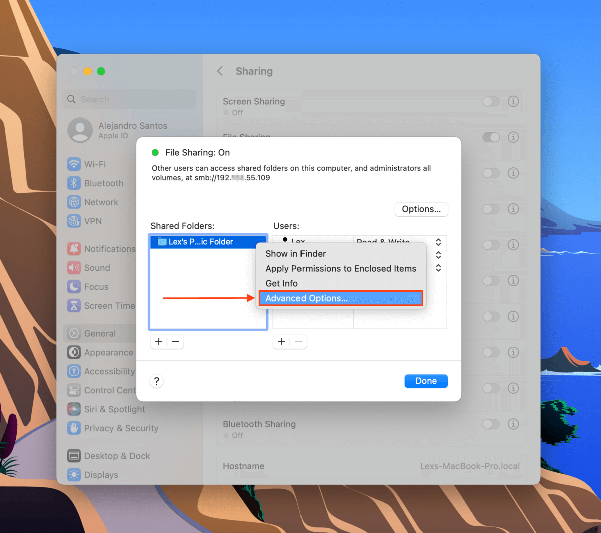

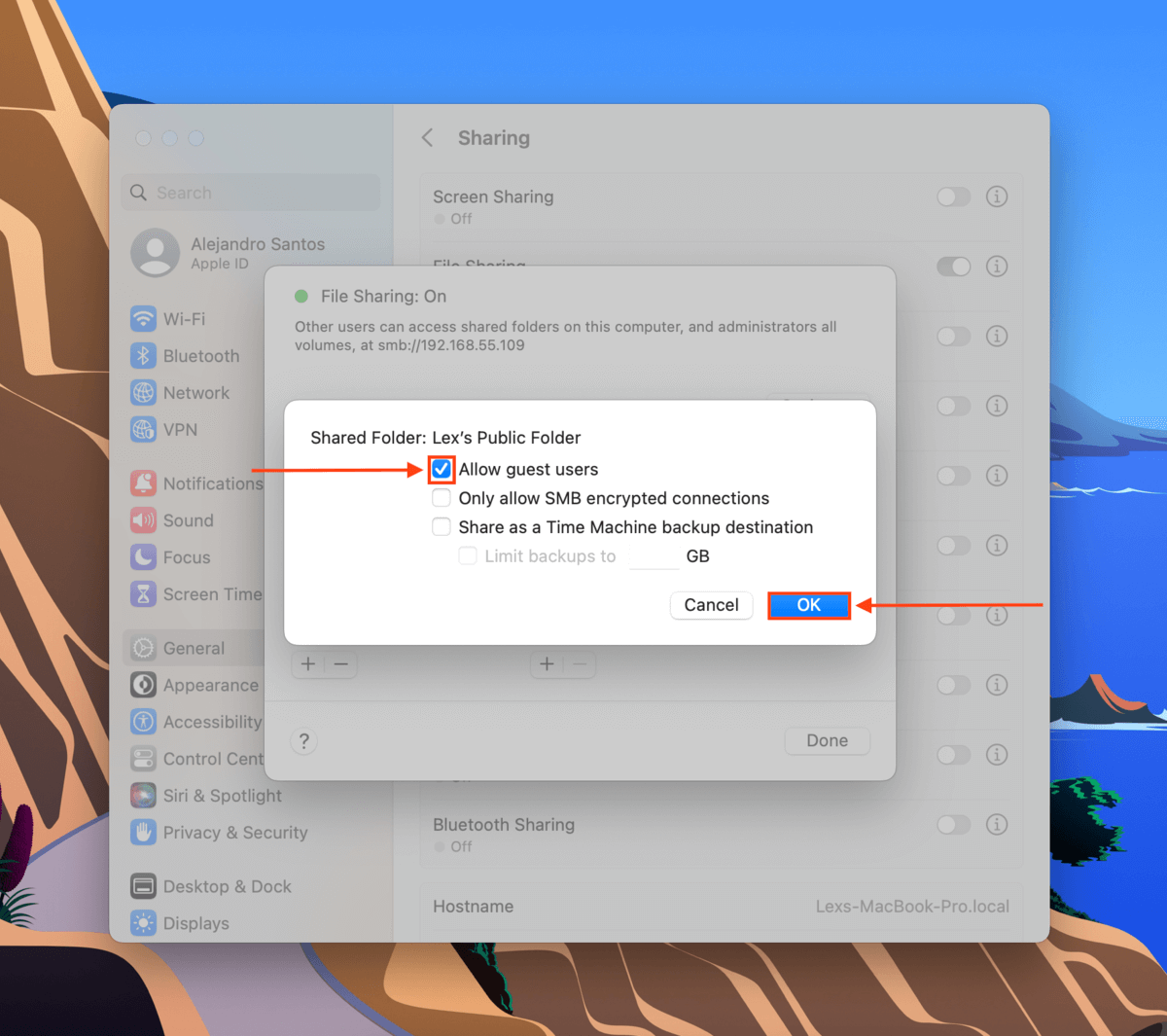

  7. Control + click the folder/s you want to share and click Advanced Options…Advanced options in File Sharing
  8. Enable Allow guest users and click OK and then Done.Guest permissions in File Sharing

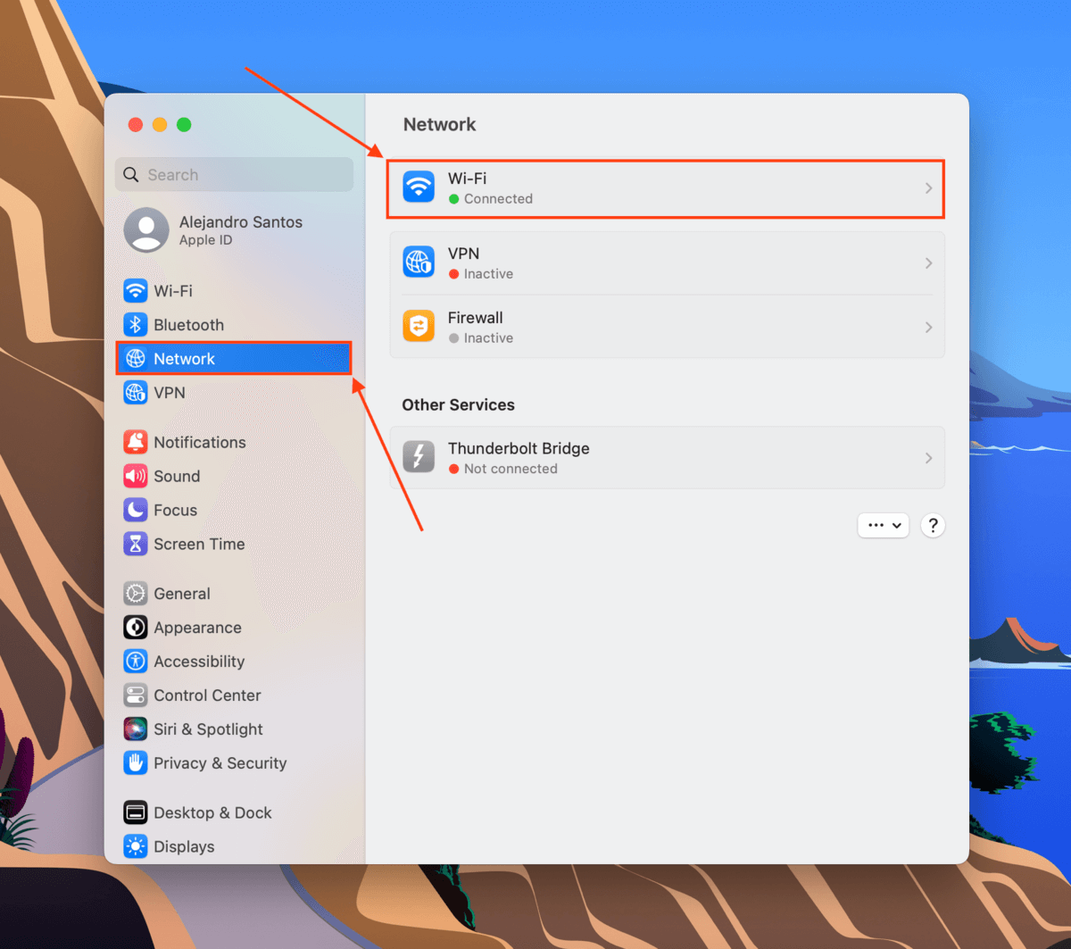

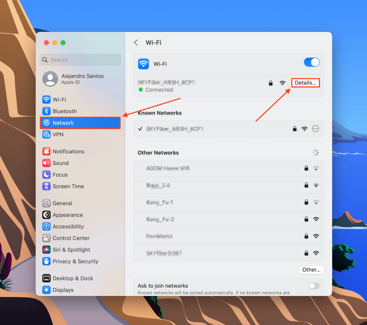

  9. Back in the System Settings window, click Network on the left sidebar and click Wi-Fi.Network tab in System Settings
  10. Beside your network name and status, click Details…Details option in Network

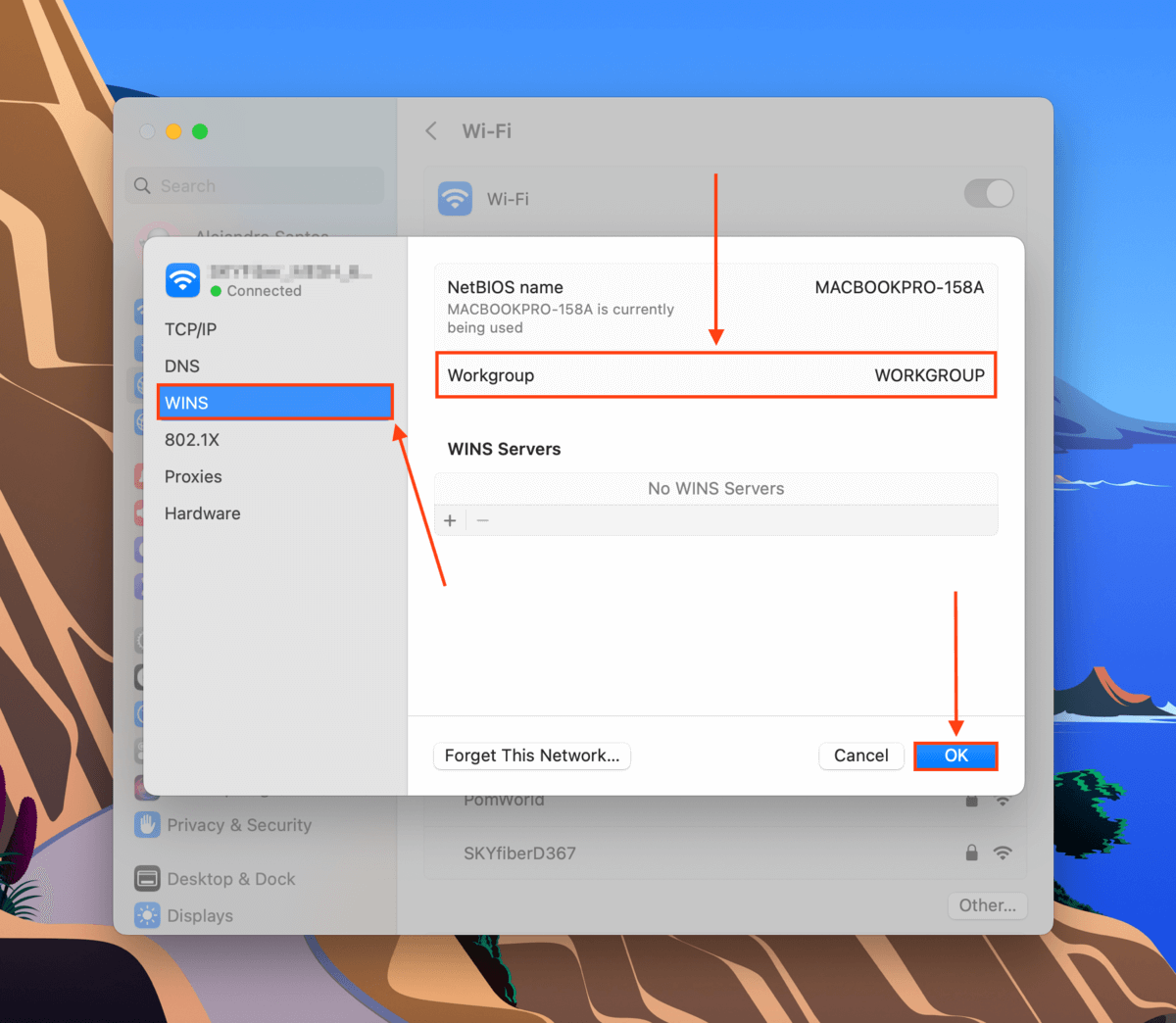

  11. Select WINS on the left sidebar and type your Windows computer’s workgroup name. Then, click OK.Details menu in Network settings

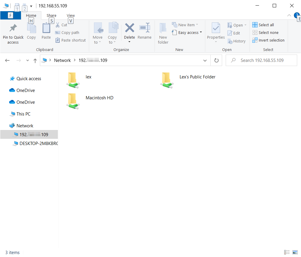

In the search bar, type the IP address generated by Mac in Step 4 above but remove “smb”. Then, hit Enter. A dialog box may appear and require you to enter the username and password you use to log in to your Mac.
network ip address in the search bar
Once you’ve entered your credentials, File Explorer will allow you to freely transfer files between your Mac and your Windows PC.
Mac network folder in Windows shared folder

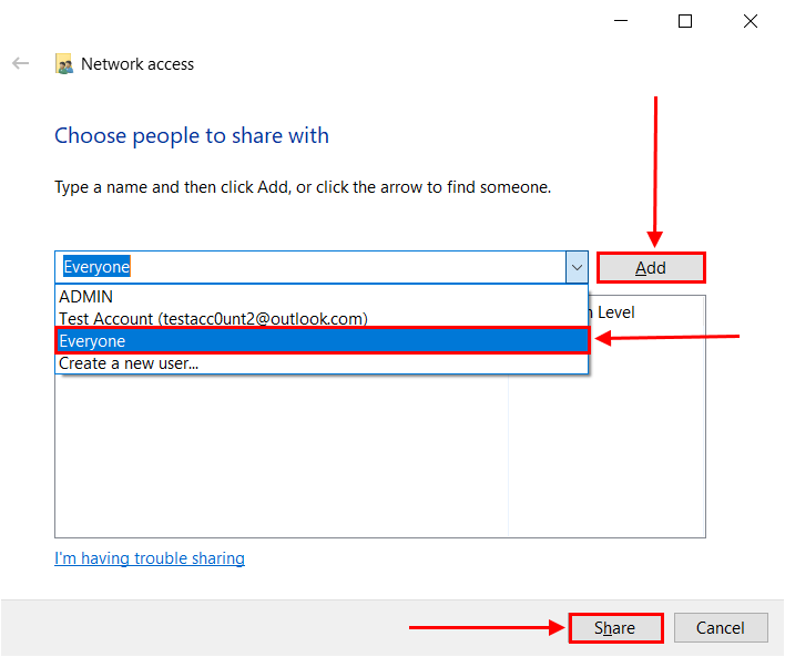

  1. Create a folder anywhere in File Explorer.

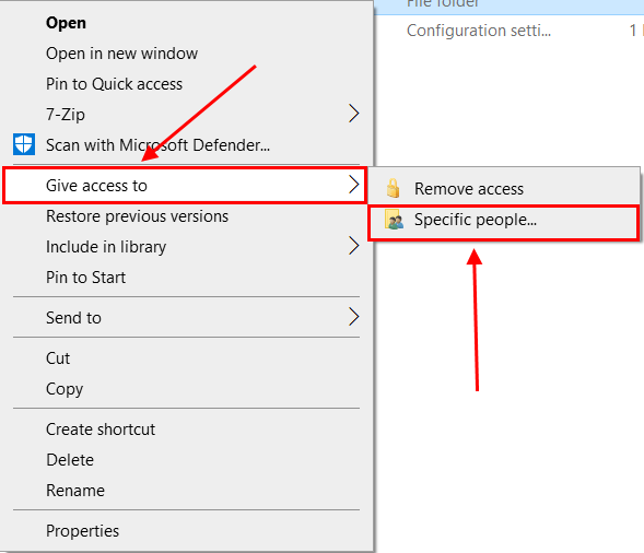

  2. Right-click the folder > Show more options > Give access to > Specific people…right click menu
  3. Select Everyone. Then, click Add > Share and click Done once your folder has been shared.network permissions in Network dialog

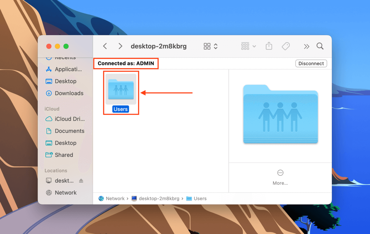

On your Mac:

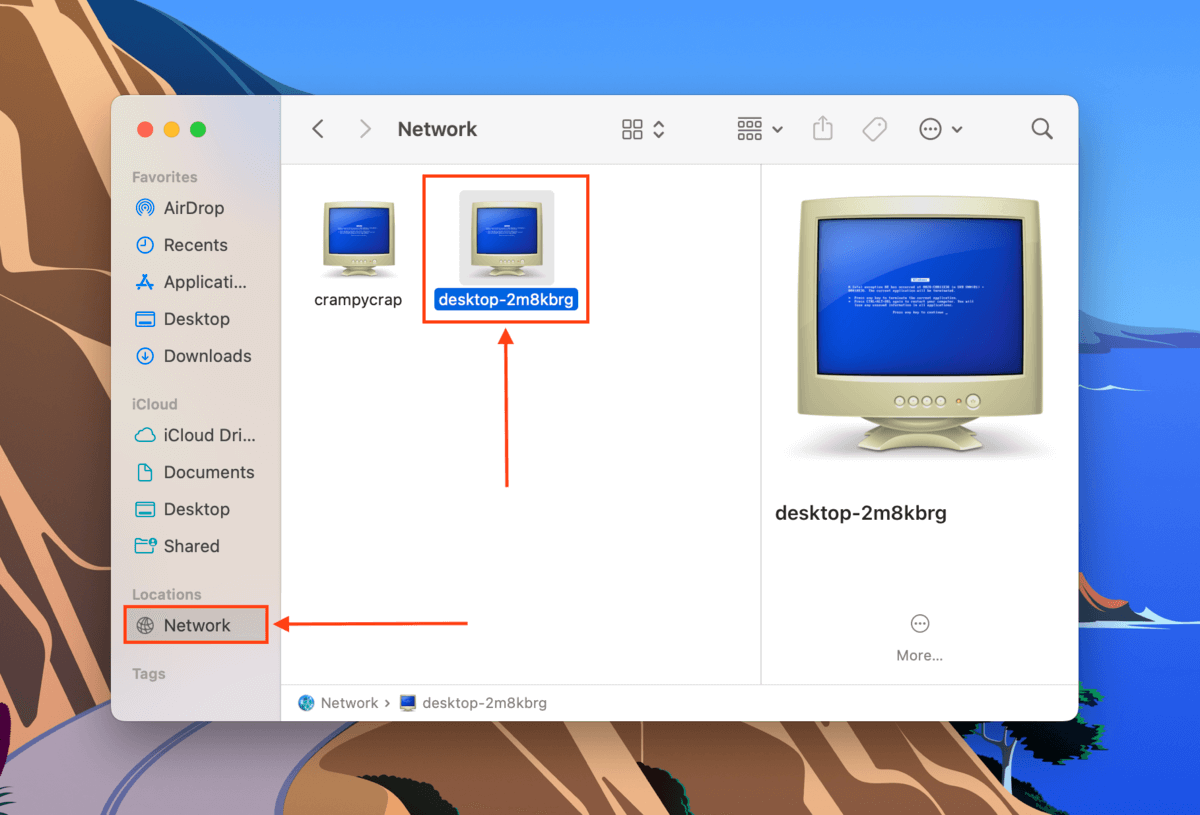

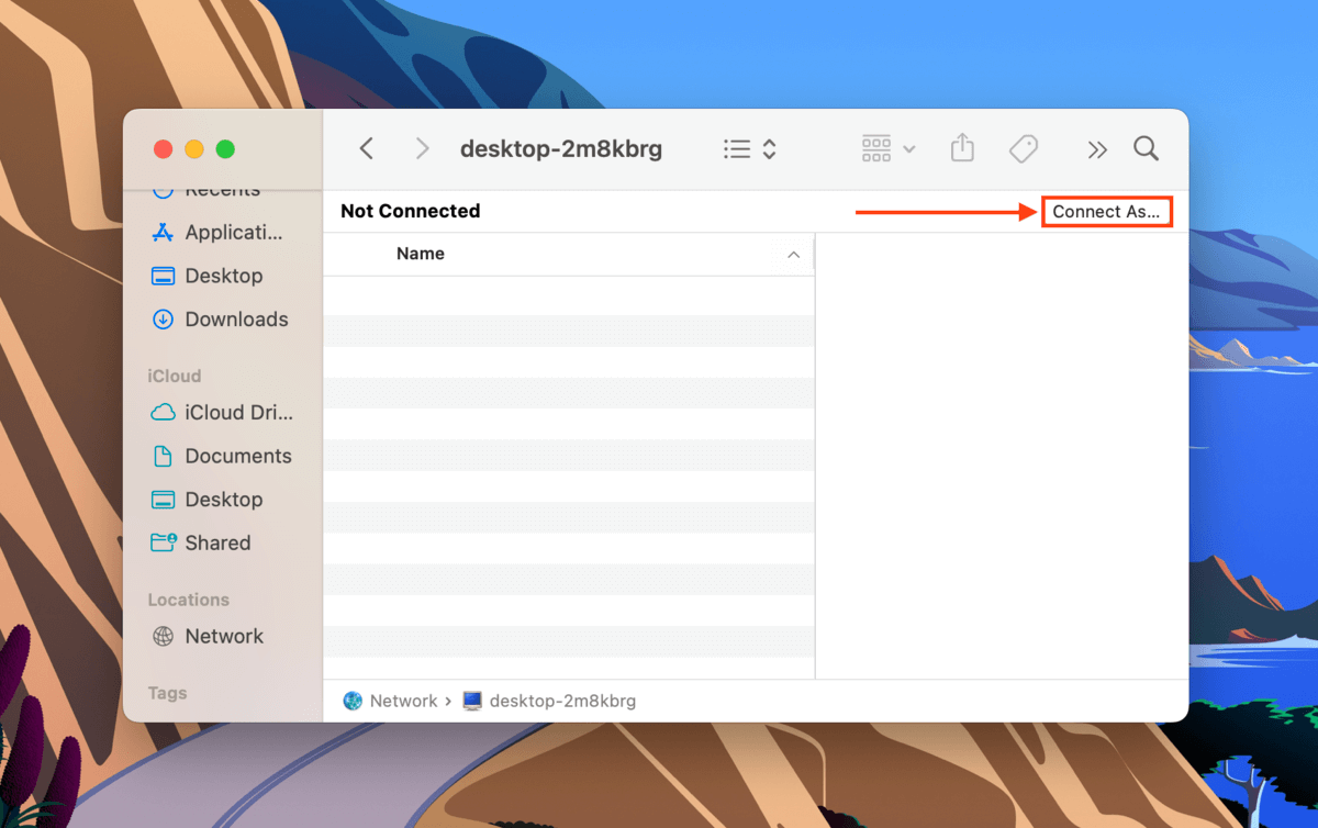

  1. Open Finder and click Network on the left sidebar. Then, double-click your Windows.Network in Finder
  2. On the top-right corner of the Finder window, click Connect As… (Click Connect again to confirm if prompted).Connect As button in Network

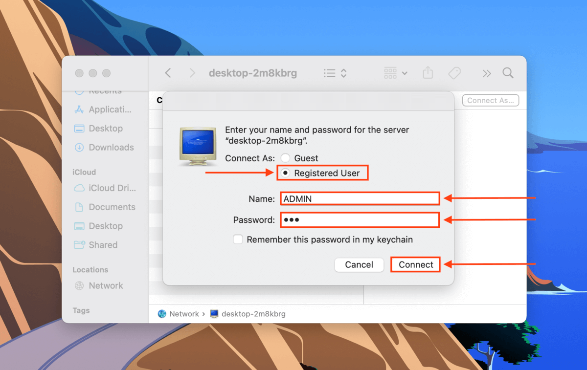

  3. Select Registered User and type in the Name and Password of your Windows PC. Then, click Connect.Connect As dialog
  4. Finder will indicate once you’re connected. Then, it should load up your Windows folder.Windows Folder in Mac Network folder
